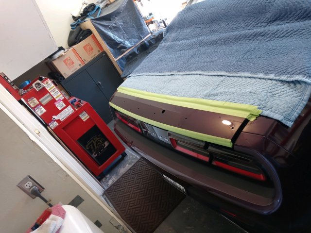

Do NOT scratch the new Car..........
Near New take off spoiler $150 plus actual shipping FedEx Ground.
UPDATE: SOLD on FB.

Fill the holes and leave it like that!
There are a few of the Stock Demon record hunters running no spoiler. Looks goofy to me. I already installed the SRT Performance Spoiler, so too late. I am not going through that again any time soon.
Also I have no issues with the camera function after the install. If anything it's a wider angle. You can see the bumper and still see plenty of sky so not sure what the issue is with some people.

Been thinking about making that change. Any pointers?
#1 you have to remove the carpet on the underside of the trunk lid. So just do it. #2 you have to pull up and keep substantial tension on the spoiler to release the plastic Christmas tree/truss clips (4). I stuffed folded terry cloth washrags under the spoiler. To release them I used a long screw driver levered into the access holes to pop each side. If there is enough tension you distinctly hear each pop. One person I saw used long needle nose pliers but they must be VERY long. One other person I saw just cut them. But I plan on selling the spoiler so I preserved them to make it easier for the buyer. To release the adhesive I carefully used a flat blade screwdriver. These adhesives release as they are stretched parallel to the paint surface. So if you can imagine I plunged into the adhesive near the paint surface about 1000 times and slowly but surely the release was complete.
I would also plan on gutting the trunk and getting inside. I use a milk crate to step on and climb inside. At one point I was sitting on the Battery with my feet in the spare tire well.
Do NOT do this if you might be having a bad day or if you do not have plenty of time. I think it took me about 2 hours.
