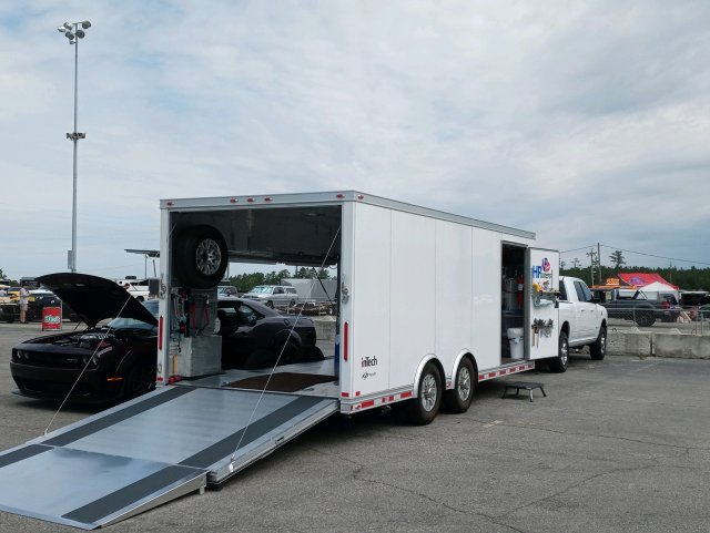

12 Days
5441 miles
93Hrs, 49 Minutes drive time.
$1407 Fuel
457 Gallons
$300 hotel (3 nights)
11.89 OA mileage
Truck set a P0299 code just west of Phoenix AZ on the way home. I reset it, and so far it did not come back. Fluke, or a bad TurboCharger? It drives fine with plenty of Power.
Got the Grip Tape on the ramp that someone linked on Amazon (thank you). So, hopefully no more damaged Flares. Also helps line up the car before sending it.

Thats a nice setup.

Thats a nice setup.
Thank you.
I thought about ordering a new one to fine tune some things that I did not know. I like to learn and I am constantly trying to get things dialed in. But, I have so much work in this thing I think I will just stick with it.

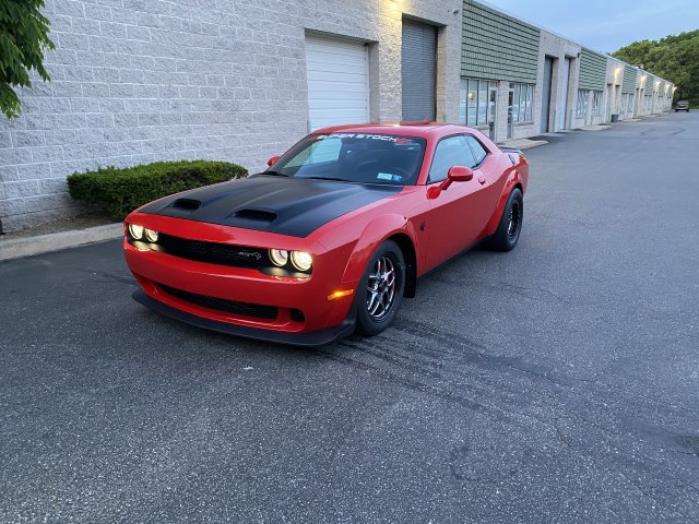

Zero rubbing! Just in time for first track day with SS. I will swap out during day to stocks to gauge times.

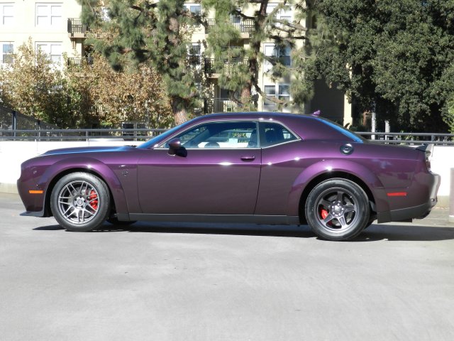

They are somewhere in between. This setup is 60 pounds heavier than the Win Lites and Hoosiers. For instance the stock wheel and tire is 58 pounds and on the front this setup is 45.2 pounds and the rear is 52.8 pounds. More info at the beginning of this thread on what the front is. 18X5 Forgestar F14 and Sportsman SR front skinny. Rear is a Stock Demon Wheel with a Hoosier Drag Bracket Radial 29.5/11.5R18.
THIS PIC I JUST TOOK FOR YOU
Gunmetal gray with Hellraisin looks perfect! Would love to see a side by side pic of the SS granite wheels next to the gunmetal. Looks like gunmetal is a lighter shade but can't tell how much. Was it expensive to have the demon wheels powder coated? I will more than likely find a set on ebay and have them done as close to granite as I can get.
The Back Demon wheels I had Powdercoated turned out a little light in my poinion (compared to the Forgestars I was trying to match to). I think I paid $120 each. It was more because of the color, she told me. All the satin black wheels I did were $75 each. Here is a pic with the Forgestars on the front and the OEM wheels on the back.
