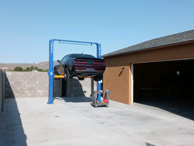

Y E S !

im jealous
Thats pretty kick ass. Now going to look at the jobs available in Arizona

I was wondering if this was going to happen. Yep, I'm jealous too.
Maybe install one of those RV carports for some shade.

Very nice.👍
Got to love the states with that kind of weather. An outside lift would never happen here in the rust belt..😖
It can happen here, just won't use it much in the winter;)

Wish I had the neighbors fer 1. Being on the Gulf Coast,, even this time of year is not condusive to out door activities. Not like Az.

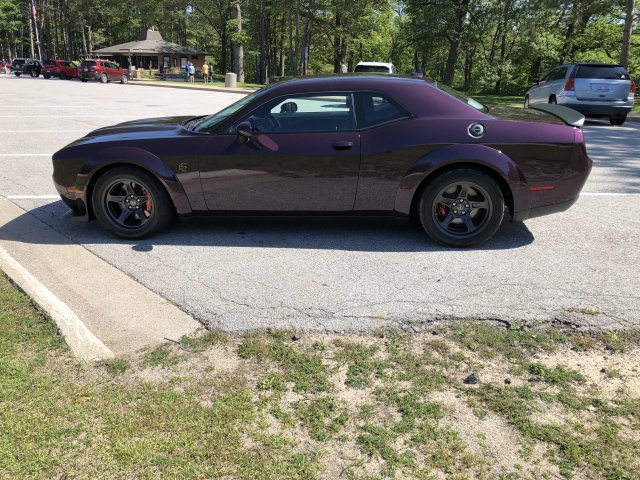

I think Ron’s madd at me for getting his twin !
Get to work on that Spoiler...........
