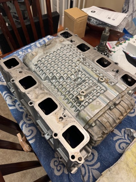

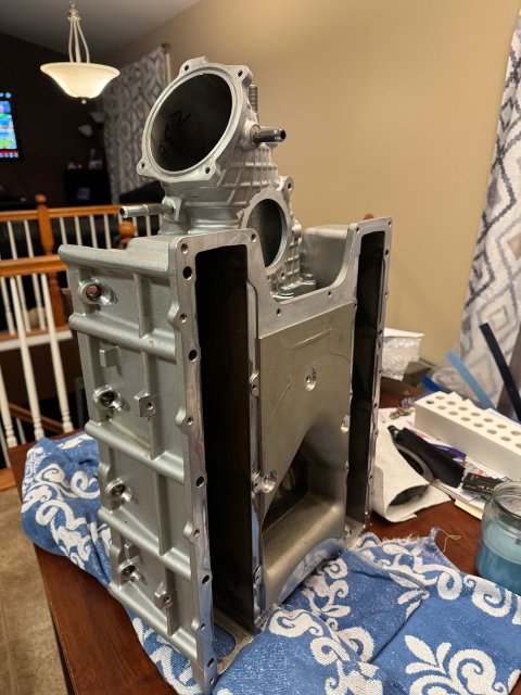

IMG_1205.jpeg IMG_1203.jpeg IMG_1202.jpeg IMG_1199.jpeg IMG_1198.jpeg IMG_1196.jpeg IMG_1195.jpeg

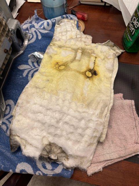

results of not cutting holes into the diaper. Did it affect performance no, did it shorten the lifespan of the blower… who knows?

To clean off the sticky and icky from the bottom, I used gasoline and then wiped it with simple green.
@fumanchu182 , need to get them vents open or your going to blow the seals out of your supercharger.
Would anything on the blanket indicate that?
YES, just use a sharp object to poke a hole and move the material back around the rounded boss. Easy peasy.
Just in case you were wondering.
Ever remove a glued on blanket? Stuff seals like Flex Tape. Send a blower in for repair with a blower blanket stuck to it and they’ll send it back to you or charge you hundreds to remove it and it’s residue left after pealing it off.
I like Kong so I took it off and cleaned it well. Gasoline took it right off.

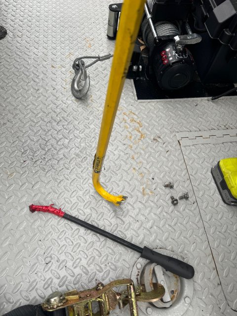

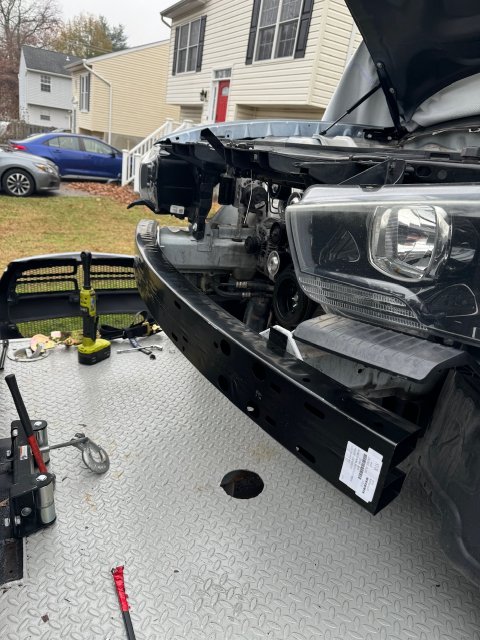

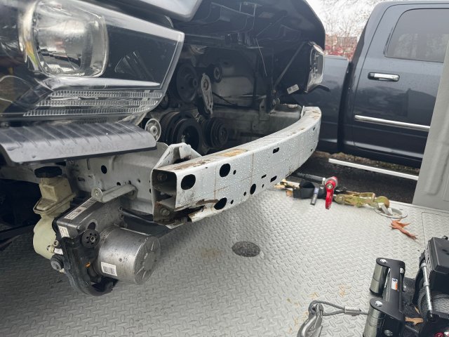

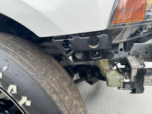

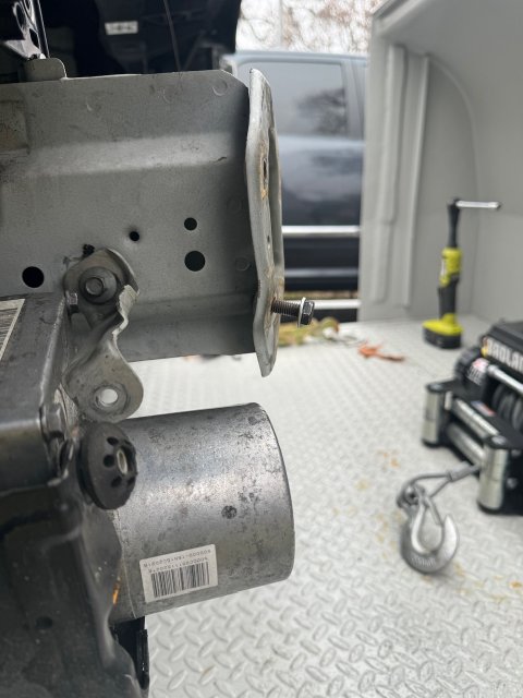

The fender is severely fcked, this was held in with screws. Did my best to get a bolt in there. Next year its getting front halved. IMG_1214.jpeg
Bumper feels 10x better and a little more rigid.

The fender is severely fcked, this was held in with screws. Did my best to get a bolt in there. Next year its getting front halved. View attachment 122599

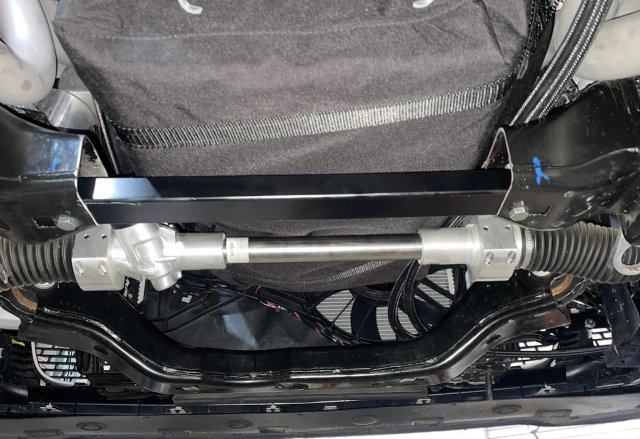

Getting there! Gotta rip out the electric steering! I’m sure someone will but that
3,899
9,623
Thread Starter #192
The flaming river setup will be purchased next month. Actually I need to do some research to make sure it will fit.

What you mean somebody. Flaming River C276DADD-85D7-4108-87C6-AF2FCAFD3F20.jpeg

What you mean somebody. Flaming River View attachment 122605
Do you think that will fit on a 2012 Charger Chasis without doing as much customization as you? I was just browsing your thread and found the same post :)
3,466
11,149
I think it will but not sure on what differences you might have vs the later model. The only mod to the frame/cradle I did is for the rear sump pan. Didn’t have anything to do with the steering.

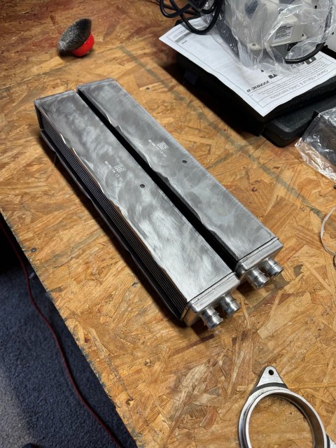

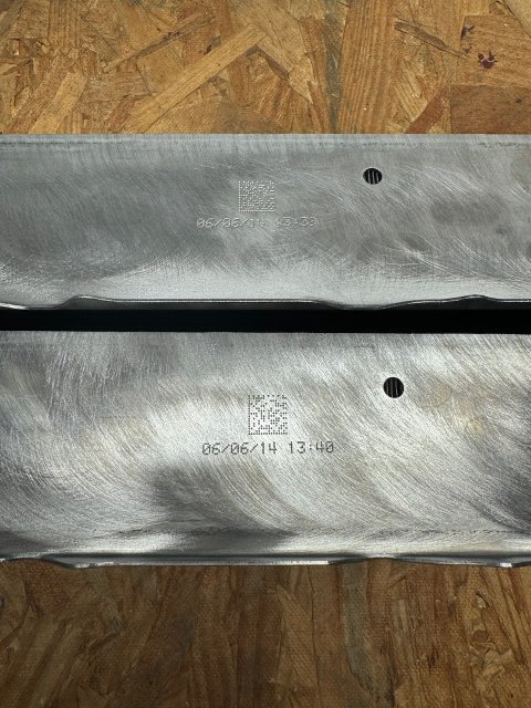

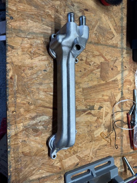

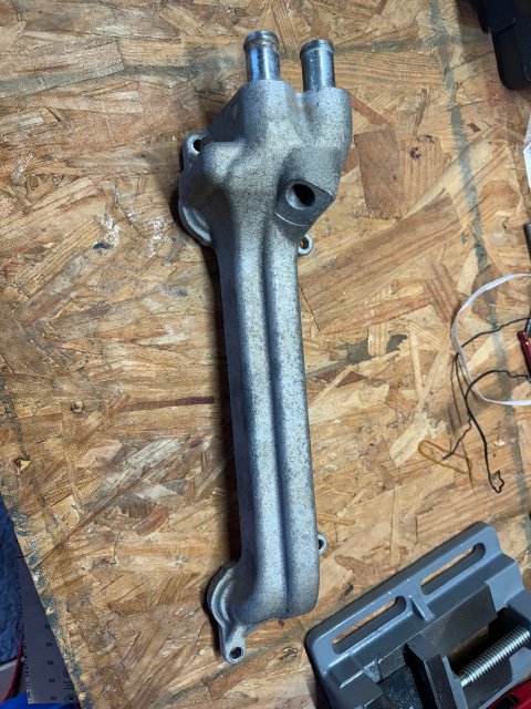

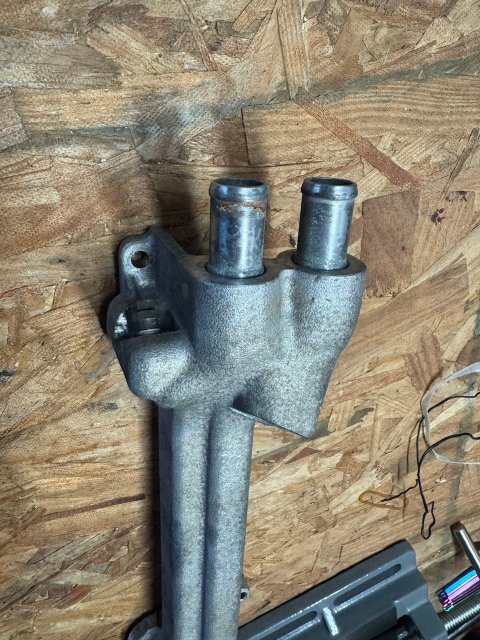

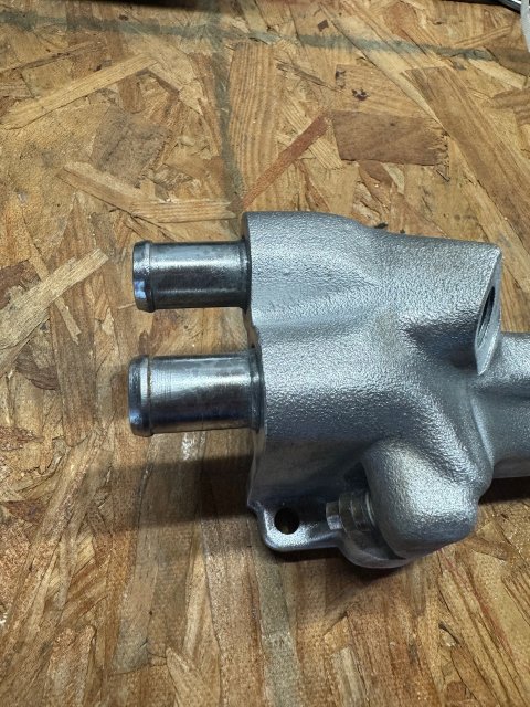

cleaned up the cooling bricks
I really have some early model parts.
After
Waiting on some fittings. Those hose barbs are being converted to AN fittings stay tuned.

You have to weld in the AN fittings.
