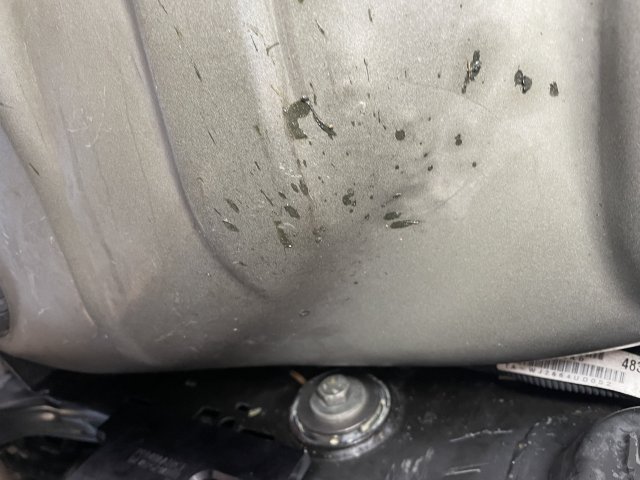

Axles finally went. Was getting major vibrations on the highway last night. During lunch got it up on the quickjacks and inspected. Good thing I have @16GoManGoHC2 redeye/demon axles. Trying to get lift time for tonight.
CD9CE48D-C2FA-4FD8-8F06-619EDC03AB1E.jpeg BF2CB20F-173C-4310-B4D6-E4DA14D69AEA.jpeg 49857552-043E-4D71-B8E6-ECD215D537FB.jpeg 20C1E31F-532E-4736-98E4-BE4AA3DEC5FE.jpeg 9B259538-F3B8-4516-ACDF-15B4FD7CD634.jpeg
View attachment 57558 View attachment 57559 View attachment 57560 View attachment 57561 View attachment 57562
Ah on the axles . At least you an upgrade ready to go .
I know just trying to find lift time. Right before the mhsh, FML.

Surgery went well!
9DCE4F40-731F-4F98-9B72-39C35925E9C6.jpeg 8D552463-95FC-4B20-B55D-34DE9887E702.jpeg 3D0EDA4B-B87A-4F9C-A175-B218BDCEBBCB.jpeg 328A69FD-36AF-4C30-BC70-251E86362122.jpeg 9CDAF4EE-D259-4F12-8A5B-9AAC0220CBC3.jpeg
