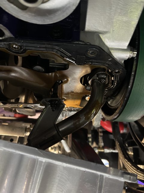

I know I have pulled mine a dozen times in the car.
ll see if I can find the pictures, no way it was coming out. And realized even if somehow I pried on something to get it out, no way was getting it back on with a new gasket that way. If you have a truck I’m all for it, but there was just no room. Needed extra inch, maybe / bit less

I no will pull mine when I get a lift free takes 20 mins
Please video lol, it would not come out. Maybe I had to dip it below the crank pulley, pull it forward a little so that the crank pulley is in the pan, push it back up flush, then slide forward. But as I recall, back was still hitting the crossmember, wrestled with it for a bit. I got it back in in under an hour
it comes out

That’s as far down as I could drop it. The back still doesn’t clear.
Yes it does. You need to rotate the crank your hitting the counter weight

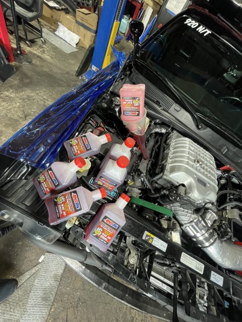

What for oil you have in it?

Ahhhh, yes, I remember the picture, this may be even the second time I’m asking lol. Sorry about that if that’s the case. Just making sure you used a break in oil not a full synthetic oil.

Was asking about your oil pan issue.
I’d be interested to see what the builder has to say about that valve. Even if you are able to get the rings to seat, that valve looked trashed and needs lapped
I think for money spent replace this thing with a new one. Problem is builder not responsible for break in
Agreed, bit of a grey a area. I guess that would fall on installer. But would incorrect break in do that to the back of the valve?

Agreed, bit of a grey an area. I guess that would fall on installer. But would incorrect break in do that to the back of the valve?
I agree with the valve.
Some thing has to be up rings installed the right way?
I have idled engines for ever getting coolant to burp and I have beat the shit out of them. Never had a ring problem
