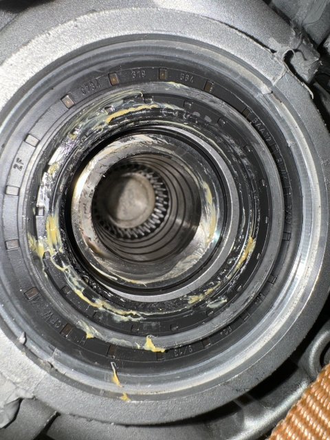

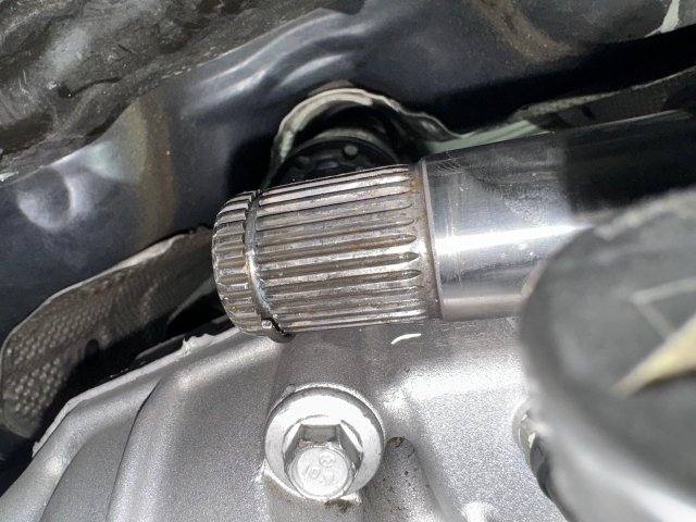

Passenger side popped right out.
RGPIII
#983
1,069
1,953
Bridgeville
Yikes, axle looks fine. I'm now scared to see the inside. but the fluid all looked fine? This one is gonna be different.
3,914
9,664
Thread Starter #1,950
My prediction is drivers side axle splines went to shit.
3,914
9,664
Thread Starter #1,951

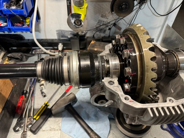

Axle will not come out. Have to get on the phone with hhp or wavetrac to see how they want me to do this. If it was just splines/broken it would have come out already.
zhc
#1019
395
1,371
2016 Dodge Charger Hellcat
The splines on the axle or in the diff could have twisted enough to make it near impossible to remove. I’ve had a few over the years.
Got one in my garage now where I gave up a couple months ago trying to pull the inner stub out on one side.
Every time they were more difficult to remove than normal, it was because the splines had twisted.
Maybe not the case here, just sharing my personal experience with it.
3,914
9,664
Thread Starter #1,953
I agree, need to salvage it so I can sell it or sell it 😂
zhc
#1019
395
1,371
Since I use old style axles, I can normally bolt a 2x6 or 2x8 piece of wood to the stub and then hammer it out. With your one piece demon axles, you can’t do that so… eh, maybe someone has a tip that’ll work for you.
