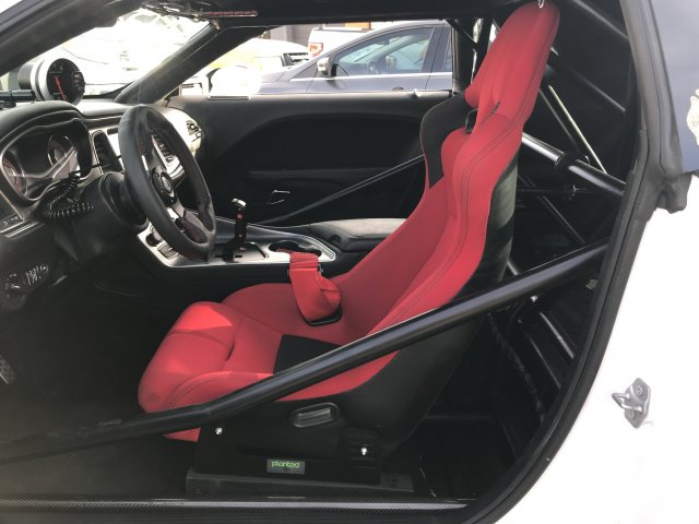

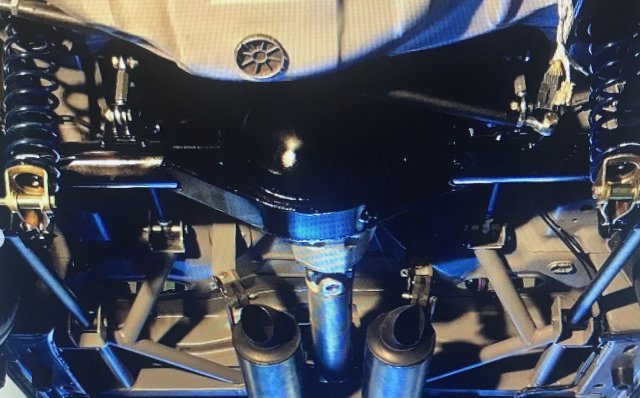

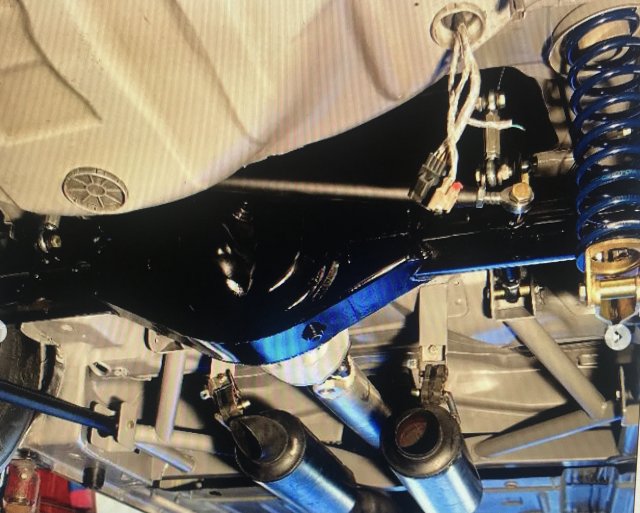

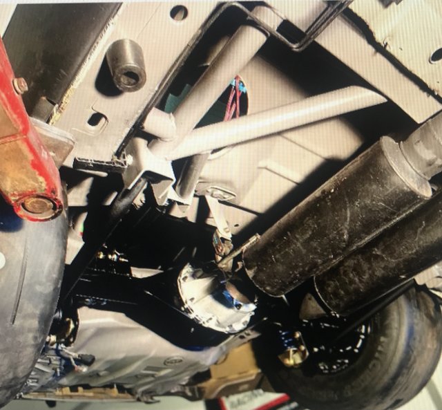

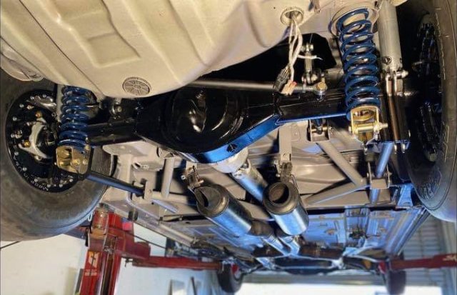

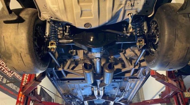

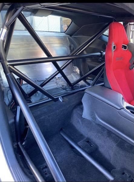

Ok.... so much for posting pictures of other peoples stuff!! We’re getting there!! Should be done by the end of this week. 🤗 72432412-A418-48F8-A66D-AFB22979A54C.jpeg 815A56C8-55BB-4232-B93B-1C266C7EB1F4.jpeg 93F6C6DC-7E9F-409C-8885-C9C4755630C2.jpeg 73E9D989-BEF0-46C0-A751-F31DCE10196A.jpeg A3AD17D3-0F54-4ED3-B8CB-129ACBD0CCC4.jpeg 6BE6D95A-3585-4599-A1E6-70B9BA49F2CB.jpeg

That looks serious! Looking forward to results.

That fat girl is really gonna run now! Can't wait to see some time slips.

looks good, any close up pics were crossmember ties into unibody. did you cut into unibody for that?
looks like a great future kit.
3,432
11,013
Thread Starter #589
These are some pics the installer posted on Instagram. They are all I have for now. I’ll be picking it up at the end of next week to return to my shop to plumb the fuel system and I can get some more detailed pictures when I’m taking them. The cutting and joining and welding is pretty extensive. That 2x3 crossmember is the foundation for everything including the 7.5 cert cage. I’ll have pictures of all that if anybody is interested/curious.

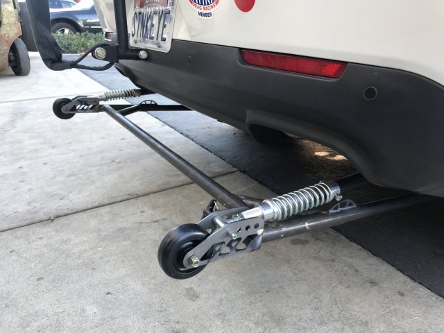

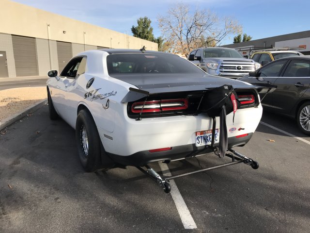

I got something hanging outta my rear! 😳 21A506A8-CC1F-454E-9A57-9D3B86E9BEF9.jpeg

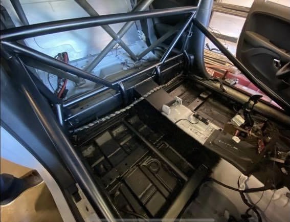

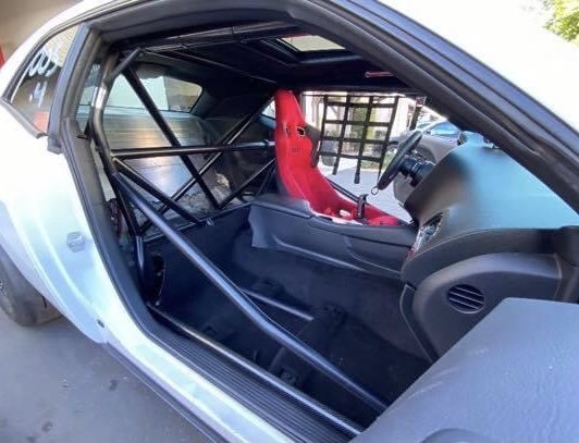

Rear seat “delete”. 43074F20-7C4A-45B9-8ED7-219966468BDC.jpeg 290FFA8A-6563-4388-9800-7DCBCD41DFB7.jpeg 601B1329-72DF-431A-8EB6-8649F53CF3A5.jpeg

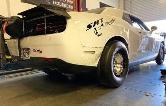

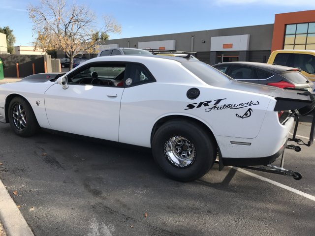

Back in Arizona! Fuel system left to plumb and then ready! D3F1C9D0-1356-4668-8935-D6E2ACEF2073.jpeg 9BA3EEB8-D6EC-4CE1-9291-2EFB073A732C.jpeg 3096080B-BFD1-4362-BB89-B1B517C02080.jpeg

@Marc W car looks really good, I can’t wait to see what kind of times you are going to putting down with the new rear suspension.

I got something hanging outta my rear! View attachment 35463
The factory exhaust cut outs were made for wheelie bars! If almost by design
