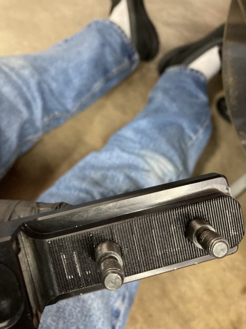

Done, from this
To this
The Speedlogix ones use serrations, each click is .030”. I set them 2 clicks out from matching the OEM arms.
6F6AB759-C6F6-47A7-82A7-48F43B5F86E0.jpeg EED06050-8C61-4C52-9B3B-8D069A5AB8A5.jpeg
Installing the 6 arms was a breeze, the Diff Lock Out kit was the time consumer. Could do a second one in about 2/3 the time this took after knowing how it’s done now. It’s ready for a test blast.

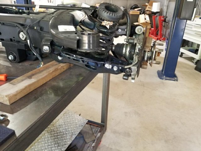

We just finished installing the AAD drag pack kit( https://aadperformance.com/collections/dodge-charger/products/drag-pack), and the BMR cradle lockout on my car. Went over and got it aligned. The guys at aad talked to my alignment shop about setting it up.
Here are some pics:
Before
dropping cradle out of the car
Detail of all components, particularly the 4 cradle mounts, notice the bushings
After-
assembly complete
detail photo
Isotators inserted into 2 of the bushings
Wheelwell view

@16GoManGoHC2 man be careful with SpeedLogix parts. They have a history of being inferior and have issues. Don't wanna surprise at launch and wot.
5,172
Nice :( I got rid of BMR stuff after seeing some of it break and thought I was upgrading to these. They look and feel like quality parts, they’re adjusting and lock up method looks sound as long as the bolts don’t come loose. I replaced the lock up hardware with grade 12.9 high quality stuff. Damn, now you’ve got me concerned again :(
4,875
11,023
#76
I have a set on my car ..... And a set on my old car . No issues what so ever. I wouldn't have sold them if they were junk or bought another set for that matter .
All good, there better then the BMR and for the price unbeatable!!

Those appear to be a shortened rear end link for the sway bar?
When that cradle was reinstalled did you have any interference or contact between the sway and the upper control arm at full travel?
@16GoManGoHC2
Do you have shorter links on your car?
3,506
8,298
#80
@NJ_Redeye
@16GoManGoHC2
Yes, I have shorter sway bar links on my car to clear 17” rims used at the track
