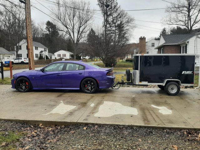

Now I tow the 4x8 enclosed to the track on the 2.5 and average about 10.5-11mpg at 900+ wheel doing so. LOL

Welp sounds like it’s handling it pretty well. Pics of trailer? Been contemplating that myself
4 x 8 x 4 - bought before big dick competitors got the trailer rule changed from 4 x 8 x 4 to any single axle.
I like it. What do they change? Can have a bigger trailer now?
