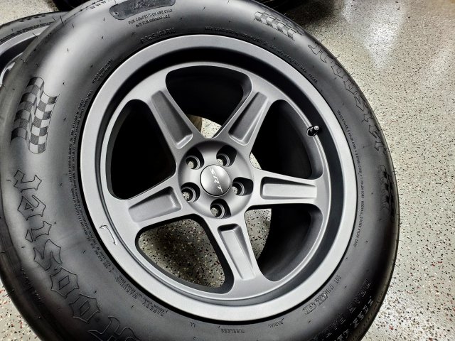

Weekend did not quite go as planned... In order to put the Super Stock on the lift to install the diff brace, I had to take the "current occupant" (99 Trans Am WS6) off the lift and trade places. Lowered the Trans Am down, fired it up and it felt rough... Backed it out of the garage and it died right in front of the garage door. Stuck a fuel pressure gauge on it and confirmed the fuel pump was dead. Oh well, pushed it back in the garage and put it back up in the air. Might have to put the diff brace on the Super Stock the old fashioned way--on the floor with jackstands!
I did finish plastidipping my Demon wheels in anthracite gray. They are a very close match in color, however the Super Stock wheels are glossier. I even put some "glossifier" on top of the plastidip, but it didn't help much. At any rate, I think they will look fine mounted up since the fronts and rears won't be right against each other. Probably will not be able to tell at all while making passes, which is all I was hoping for! 20211004_211448~2[616].jpg 20211004_211440~2[615].jpg 20211003_163046~2[622].jpg

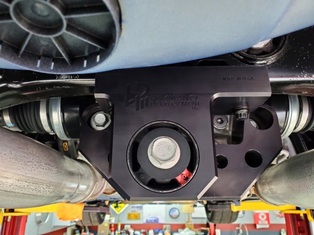

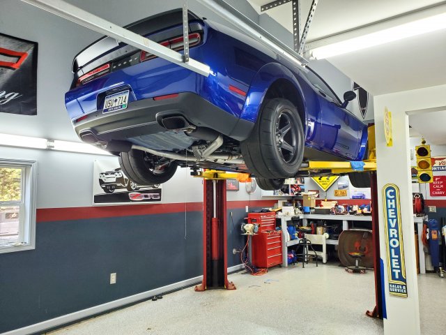

Tried my best to go racing this evening but was too rushed by the time I got around to working on the Super Stock... But at least I'm ready, aside from putting on the Demon race filter. Got the diff brace put on this afternoon, and mounted up the big 325/45/18 tires! Btw, check out the weight gauge on the lift... she's portly! Sadly the gauge seems relatively accurate! Hoping for good weather next week so I can finally get some baselines! 20211014_171945~2.jpg 20211014_171911~2.jpg 20211014_171437~2.jpg 20211014_170325~2.jpg 20211014_163656~2.jpg 20211014_154233~2.jpg 20211014_145429~2.jpg

Tried my best to go racing this evening but was too rushed by the time I got around to working on the Super Stock... But at least I'm ready, aside from putting on the Demon race filter. Got the diff brace put on this afternoon, and mounted up the big 325/45/18 tires! Btw, check out the weight gauge on the lift... she's portly! Sadly the gauge seems relatively accurate! Hoping for good weather next week so I can finally get some baselines! View attachment 55737 View attachment 55738 View attachment 55739 View attachment 55740 View attachment 55741 View attachment 55742 View attachment 55743
Have to admit those 325/45/18 tires look amazing on a widebody --- no more fender gap !

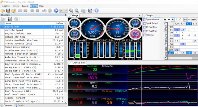

Only made 2 passes due to rain that came after 2nd pass, and the fact that I video all of our local 864 Top Ten List races which were also going on that night (side note: I was the #1 on the 864 list for about a year in my C5 Z06 twin turbo 427ci). We got delayed by the rain quite a bit as well as several track cleanups so no more passes after those initial 2. Car ran 6.88/101 and 6.93/100 and I was REALLY confused. I had the car in Track mode, chiller on during the passes, and it was on 98 octane. Car dead hooked with 1.50 60 ft's both times. It wasn't until after I got home that I figured out an issue... And this is why you should always datalog! The car shifted 1-2 at 5000 rpm's, 2-3 at 5700, and 3-4 at 6200. If the logged MAP Kpa is correct, then boost in the first 2 gears was around 12 psi (what is everyone else seeing for boost?).
Since Dodge's are new to me, are the shifts based strictly on output shaft RPM? (in GM, it's a combination of MPH and RPM). I know my speedometer isn't correct with a 29.5" tire but thinking it's more the TCM adaptives than a matter of programming my tire height. I'm going to go back next week and get some back to back passes and see what happens, and I may just throw on my Weld 17x10's on with 28" drag bracket radials since traction does not seem like it will be factor. I really like the look of the 29.5's and how they hooked on the street--they may become my "drive around" tire.
