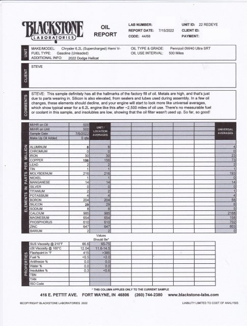

I know some don’t do a Blackstone at first oil change, but this is what it should look like.

Oil analysis report came back for the 170 and looks reasonably typical. Keep in mind first oil change and only 730 miles. I am now sitting at 1280 miles soooo
Track time is in near future. Speedy I look forward to your results too, mine took almost a month they must be busy.

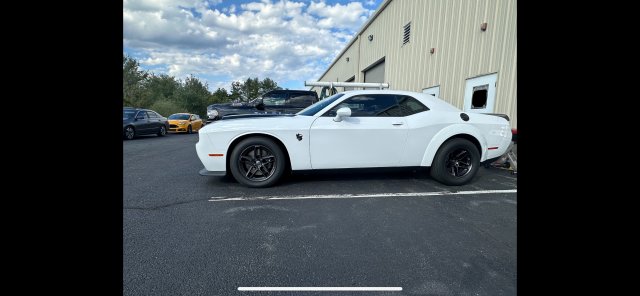

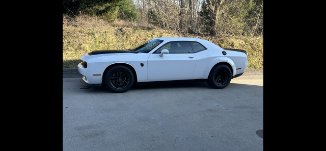

Here it is along with few other pics of “White Ice” it will not read that on the IP plate on dash, it’s just what I call it because of body color and one of the last true Dodge Ice Hurrah, literally because of Dec 12 Build.
Blackstone report, and a few pics of car off trailer from picking it up, First order of business remove banana peal wrapper that’s on stone wall then later on all other shipping protection. Send to PPF shop. Wait for sand on roads from NE winters to be washed away, Follow proper break in, change oil early @ 730 miles, open filter inspect especially with questionable 170 metallic oil debates.
Full nose with Expel Ultimate, doors, lower quarter in front/behind rear MT tires, 30% Tint. Now at 1280 miles. Getting close to the magic 1500 mi.
