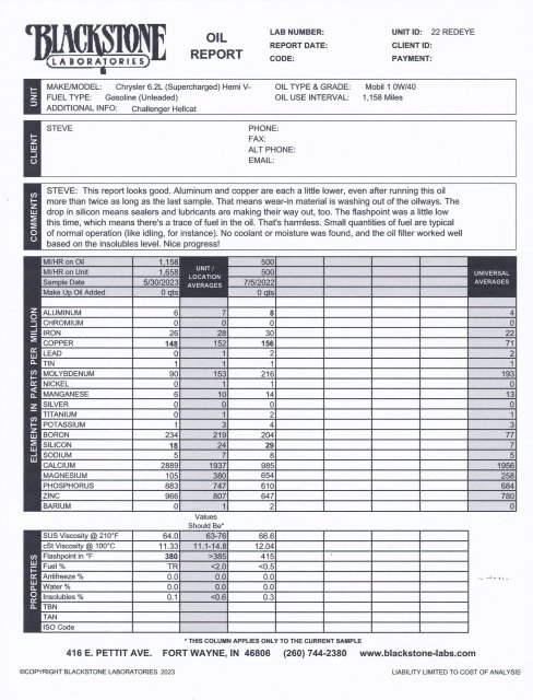

@Demoniccat car looks great.
Your analysis looks like a new engine analysis to me. Take a look at NJSteve's from his Redeye a couple posts above yours. His had WAY more copper for some reason and other stuff is very close.
I may do an analysis on my next oil change at 2,000 miles.
Here's the second oil analysis on the Redeye engine at 1,600 miles: Copper slightly lower by 8 PPM. Oil tested was Mobil1 0W40 with around 1,000 miles on it. I have another oil change coming up soon. Car has 2100 on it now Pennzoil 0W40. I may do the TBN on that to see what the additive package shows for effectiveness. (Update: I changed the 500-mile oil yesterday and I am sending the sample out today. Nothing much more than a slight residue found on either of the magnetic drain plugs (pan & cooler). Cutting open the filter later today for a look-see.)
