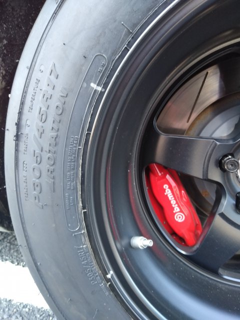

Out of curiousity, OP, who did your tire mount and how long between the mount and the drag racing?
A place called Tirerama did the tire mount. Told them to use nothing but the high tact glue to put them on. I think I had them mounted in June and raced that set in September. Pretty sure the set before this moved too, because I noticed the balance seemed off at higher speeds.
I don't think I'll use that glue again, doesn't seem to be helping enough. The only plus I can see out of this, is possibly less strain on the drive train since the tire is allowed to spin on the wheel. It's not a lot of spin per pass, but I may consider beadlocks in the future. I still 1.4x 60ft so, it's not all that bad, lol.

I had them use Permatex on my DR's, 315 Nitto 05r's, they moved about an inch, after that they have been rock solid.
Same stuff I had my tire guys use. They seem to slip more than I like. For now I will deal with it, until I feel like stepping up to beadlocks.
