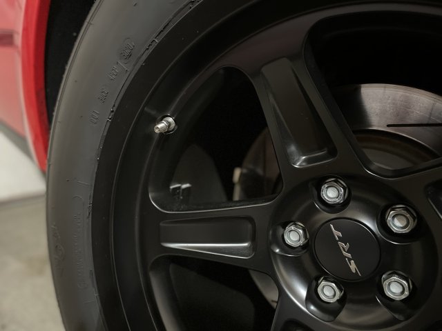

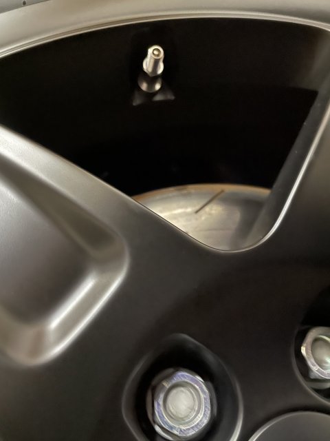

F6990EE6-C172-4894-84A1-4B8420AF7750.jpeg 105B1820-91BE-40DE-AF16-06D4536E326B.jpeg 247F2D07-D3D8-4B3D-977C-F7EE5D64616B.jpeg
They look badass too!
