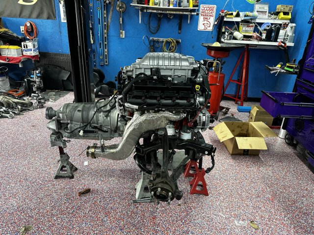

Transmission now in. Shop is/has been short handed so they're trying to chip away at this as much as they can. Fabricating the water tank for the FI Interchiller system today and will then get that installed. I imagine after that it's probably just some exhaust work and we're done. Hoped to pick up this week but feel like that may be a long shot.

Finally got the hater maker special stuffed into the engine bay. We’re close, folks. Thanks to anyone who has stuck around. This has been a serious test of my mental health. :ROFLMAO:

Chiller install went fine as far as I know. These guys are a dealer so nothing they can't handle. The reservoir for the 2.5-3 gallons of fluid is being custom built and tucked into the fender for a clean install. Should run very very cool for me.

Too much volume. You want around 1.5-1.75 gallons. Will take a long time to chill that
Should have said capacity, we’re not necessarily going to fill it.

You have to fill it if you don’t want air pockets. It’s a pressurized system

1.5-1.75 is the sweet spot. Will be cool the entire pull and cool down by the time you’re back in the staging lanes

I don't know. They're an FI dealer and have done this install many times. I'll ask if it's too much capacity and see what they say.
