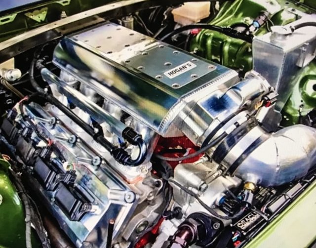

Yes. And that was part of the equation here. There will still be a considerable amount of work with setting everything up (boost control and some relocation of stuff like my trans cooler, etc) but custom pieces like those headers and intercooler… omg 😵‍💫. The setup also included his Hogan Intake. I just don’t have it yet. 93DD2D92-2D48-469A-86BE-28DB7BD0426D.jpeg

Was just going to ask about the intake… excellent package.

If I had been starting from scratch…. I probably would have opted for the air/water intercooler intake from Demon Perf. For one thing, it would have been cheaper than that $4k Hogans and custom $$$/$$$ intercooler. But…. This setup will shed 150 lbs from the weight of the car and will eliminate the need for all that ice. Sooo much ice 😵‍💫. Turbos put a lot less stress on the block and internals than a supercharger at this level and are a lot more tunable to get the car off the line. Reliability has been a issue lately with the superchargers and once set up, turbos are as reliable as it gets.

I agree 100% with everything you said.
once you get some good baseline tuning done, off the line will be a problem for someone else. And the back half… will fly by. Haha

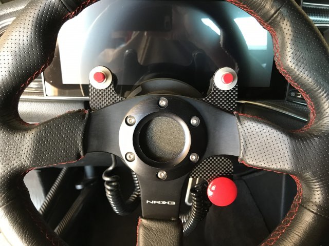

I guess I could add a couple nonfunctional buttons in different colors just make the spectators think I’m special. 🤓

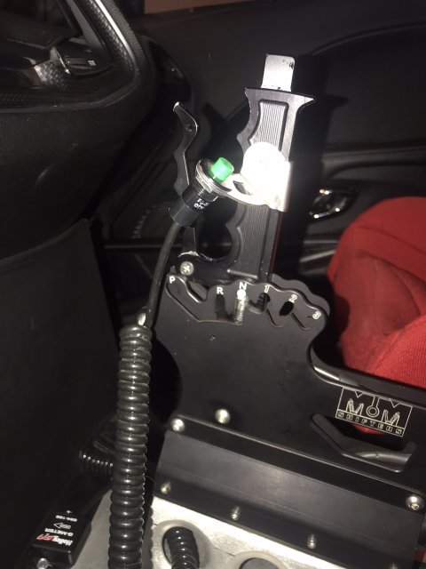

I actually do have another one I forgot about. On the shifter 🤗 61477BDB-6A62-4FD4-9BB7-8FC75A72DDC3.jpeg

That the scramble button for the turbos?
lol No I’m scared of this thing as it is. Transbrake/2-step, bump for staging and chute. The green one on shifter is line lock.
